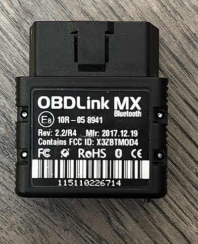

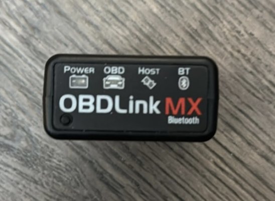

I have a used working OBDLink MX adapter if anyone is interested. $80. Located near Denver, CO.
