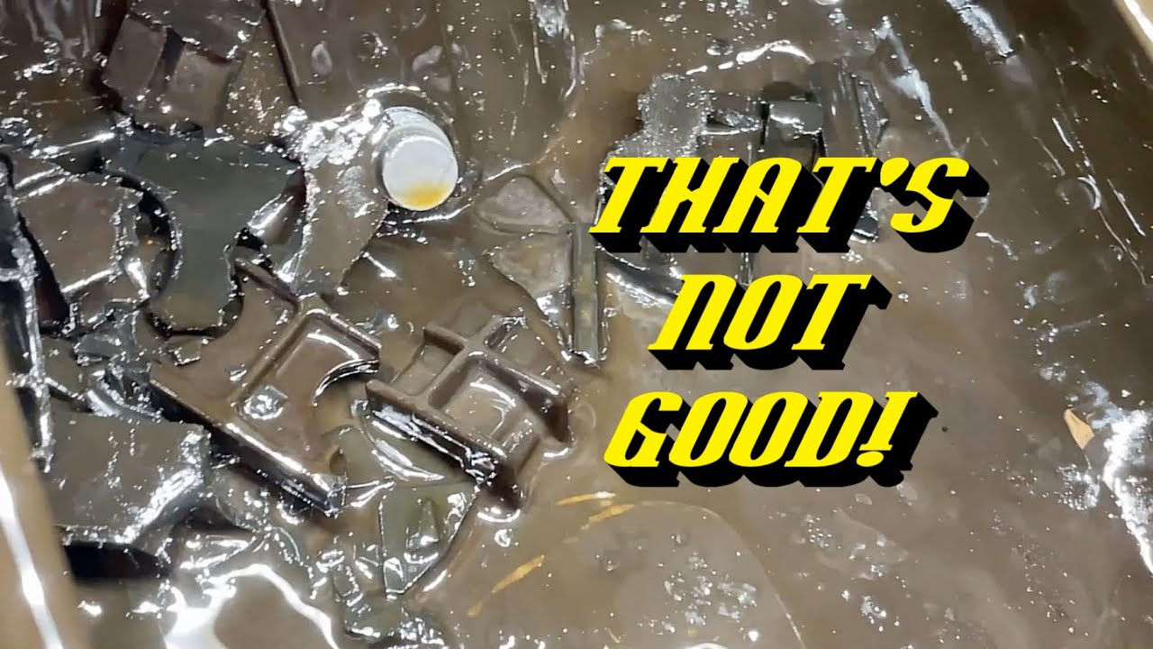

Definitely looks like your phasers are going to need replaced along with a full timing job. I'm shocked that wasn't on the list of recommended maintenance. There's good info in this video here about it.
