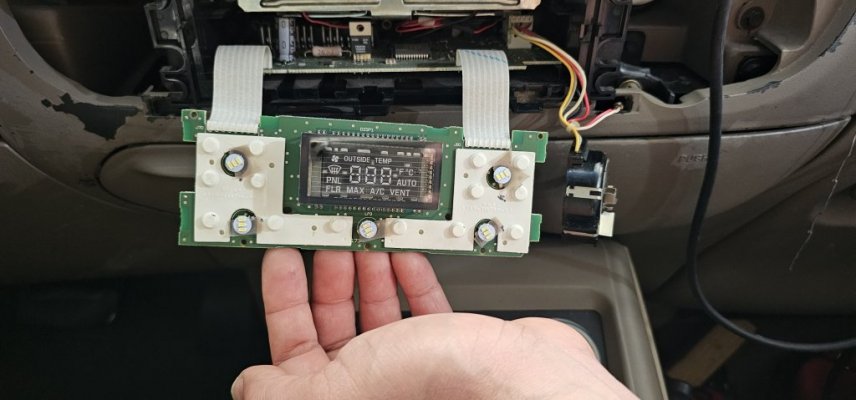

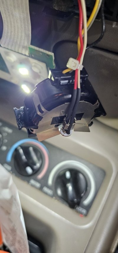

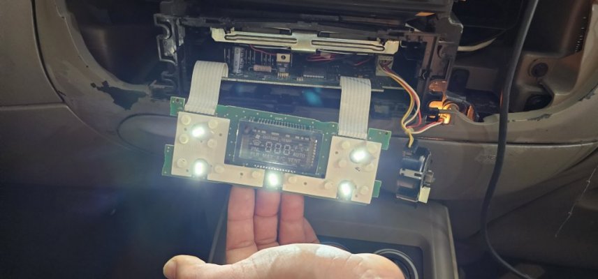

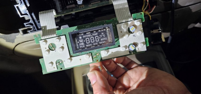

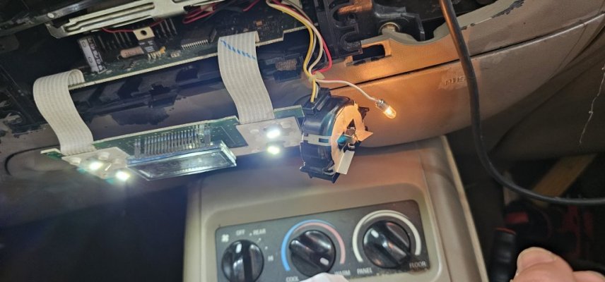

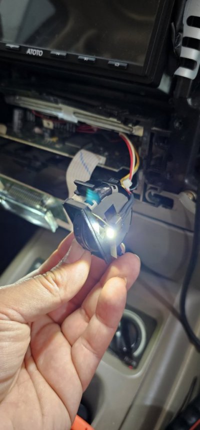

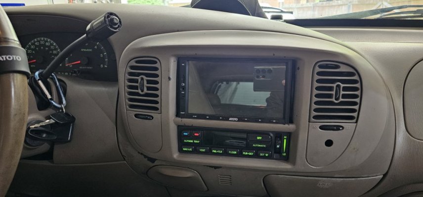

I replaced the lights on the panel because I was down to only the fan wheel bulb working. I went with flush mount led bulbs. Soldered them on and the wheel as well.
I got them from ebay. With the led they only work one way. Test them by touching them and mark the positive. And I put some tape on the solder before bending the leads to avoid shorting them out when putting the face back on.
