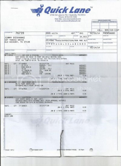

I know the answer to your loud humming front end
I HAD the same problem.
I read all the forums, watched guys replace alot of parts and never fix this.
My dealership had a TSB (technical service bulletin) about the symptoms we both have, or I HAD...
I also, did my front rotors, pads and new tires...
Still there.
Dealer replaced the wheel bearings,
still there,
Transmission guy inspected a resealed the transfer case.
still there.
Then the TSB was found! ...JACK POT!!!!
Basically, the front drive shaft always turns and spins the front ring and pinion. This creates a condition where one side of the spider gears spins faster than the other side. ????? thats the noise???? YES!!!!!!!
O.K. how do you fix it? it is a spring that goes between the gears and keeps the spider gears from spinning at different speeds. NO MORE NOISE.:patriot:
Parts they used to fix it are listed below.

Alright, I've just had all 4 hub/bearings replaced. Still getting that "humming" from the front end (so it seems). As for TSB how did you go about finding that? Was the dealership that pointed it out? Appreciate the help! Getting frustrated.

Just read your reply a little more carefully regarding the TSB. I'll contact my dealer tomorrow. Wonder if the TSB could be found online?
