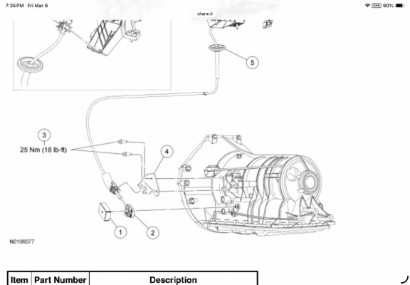

You should have a 6R80, let me get some drawings.
The shift cable rarely pops off on its own. We have to pry them loose to remove the transmission.
