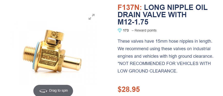

welcome everybody
I want to get this wonderful tool
Long Nipple Oil Drain Valve
My 2015 Expedition needs it
My problem is that I don't know the size of the oil drain nut in millimeters
I want to order it online
Can you help me please?
I found this site
but still I could not Know
Best Regards

I would be so concerned about a rock smashing that thing off and having the oil drain out pronto. You will give up a lot of security for convenience.

I assume you have the metal OEM plug. I replaced the metal plug (M12-1.75) on my 2017 XLT with short nipple Fumoto F107SX https://www.fumotousa.com/SX.html and a hose kit.
Be aware that draining your oil will take 2-3 times as long as removing the OEM plug but I think the convenience and lack of oil missing the catch pan is worth it. While the oil is draining I check other fluids, tire press, etc

Thank you very much To let me know the right size and other information

I run the Fumoto valve on my '16...best way to drain the oil and no mess. If that valve ever gets hit by a rock, you have bigger problems. Folks that think this can happen just don't know the location of the drain plug in relation to everything else under the vehicle. And besides the whole area is covered by the heavy felt cover, which I leave off on my Expy....
