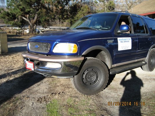

I bought this Expy to replace my 93 Exploder after the transmission let go towing my boat home from work six days before Christmas after 9 years of service. After looking around over the weekend I bought it on Christmas Eve for $1,250. It came with three 20 in rims and the stock 17in spare so I had to go to the salvage yard for a set of stock 16 in rims from a wrecked F-150 for $100. A new set of BF Goodrich All-Terrain T/A KO Tires from Big-O set me back $1,050 and I was back to work.
She does need some work but she runs strong and there are no fluid leaks underneath. I'm not ready to pull the dash to replace the heater core but would like some heat/AC if I can get the rear unit operational.

I painted the rims with flat black Rustolium and plan to PlastiDip the bumpers and trim this spring.
