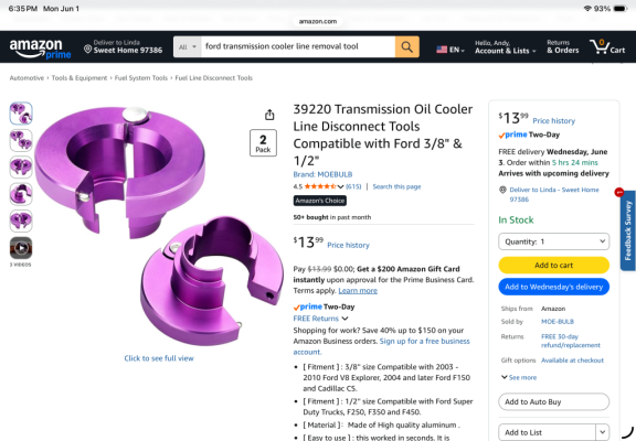

I tried all the plastic ones with no bueno. This is what I purchased and work better than factory removal tools.
