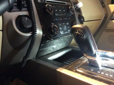

There is a hole in the firewall about where the passenger's left big toe would be if it is resting against the firewall (while sitting in the passenger's seat). Peel back the carpet to find it. Punch through the bushing covering the hole with something sharp from the inside. I think I sharpened a coat hanger. Fish it up high enough (or low enough if you want to go under the vehicle) to tape your wire to the coat hanger. Pull back through.
From there I threaded the wire behind the console and put the switch on the side of the console by where my right leg is while driving.

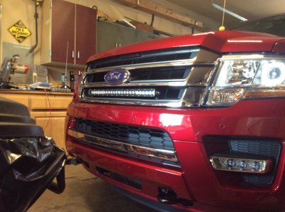

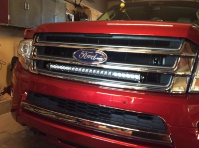

The light bar is a Blazer part #CWL524S , I got it a local Northern Tool for 68 dollars . It’s a single roll with spot in the center and flood on the ends.

It’s mounted to the plastic grill, I used the brackets that came with the light, but I shortened them to fit, they don’t vibrate, they’re nice and tight.

That wouldn’t do anything blocking air to the Intercooler. If Ford was worried about that, they would’ve moved it farther down the front end and not put anything in front of it. Looks ok, let’s see it lit up at night!
