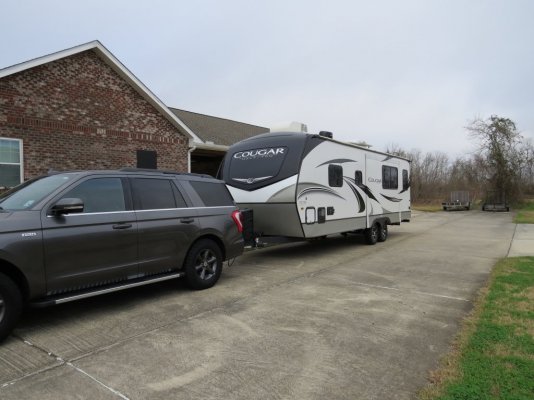

Pawpaw
Dec 2, 2021
207
149
Raceland, La.
'21 FX4 with max towing. Equalizer 12k hitch and E rated 10 ply BFG's aired to 65 psi cold when towing. Cougar 25RDS with gross weight of 8800 lbs max. Load to 8000 max when towing. Payload of 1769 lbs on Expedition and 9200 lbs towing capacity. Hitch weight is close to 1100 lbs according to my Shurline scale. 2-30 lb propane tanks..front glass windshield and 2nd AC all add more hitch weight. Keep speed in the 60-62 mph range and it does OK. 23.5 gal fuel tank keeps us on short trips and gets 9 mpg when towing. Used son in laws F250 with the 6.7 diesel and it was perfect pulling this camper. Expedition though is heads and tails better for a daily driver in my opinion!!
