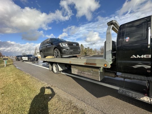

3) four days later same issue occurred. We pulled over and restarted the car, and all lights went away. But 30 min later, lights started flashing and we also lost RPM and Speedometer, plus the cooling gauge stopped working. Car still drove normally, but once parked, it would not restart
4) disconnected battery for 10 min and car would still not restart. Car sat for 2+hrs waiting for tow.
5) After pushing car out of garage to get on tow truck, car actually started and seemed to be fine !?!
