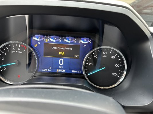

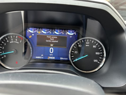

I posted about this issue 2 years ago Here, and wish I pushed for lemon law back then. For anyone on the fence, lean-in early with the lemon laws. ford has dozens of "parts back ordered", or "we're waiting on a fix" etc. the best course of action is just to tell them "hold the vehicle until the part comes in" every single day they have your vehicle counts to the lemon law.
I was dumb and brought it back 6-7 times over the course of 3 years, every time with a "we fixed it by reprogramming", which never worked more than a few weeks.
Be warned, use the lemon law.
I'm on visit #8 now, dropped truck off mid-June.
Week one, They thought it was programming, "oh we just need to flash it, happens sometimes" well, they couldn't get it to program, so they decided it was faulty and needed to be replaced.
Week two, they replace the CCM it took a few days to get, and thought it would be programmed in a few hours. Wouldn't load the program.
Week three, they finally were able to force the CCM to load the programming, but now it wouldn't calibrate
Week four, we had to open a customer satisfaction case due to 4 weeks of no resolution, they replaced a pig tail, and Ford SME at corporate had them pull the bumper 3x to test each parking sensor, radar sensor, and inspect each harness.
Week five, still can't get the error message to go away on the dashboard, but "hey, we were able to get the program to load and it passed calibration".
We're about to get into week six in a few days, the local advisor is already starting to indicate they don't want the truck there anymore, last status I got: "We think it's a bad program for the CCM module, they have a known issue with those throwing error messages, so we may need to wait until its released in October."
I've literally gone the entire summer now without my family SUV.
it's 3 years old, B2B covered the issue above, but I have top ESP coverage also.
I'd consider replacing it for the headaches, but it's been maintained so well and in great condition. Plus, why should I have to replace it when the warranty should cover all these parts and work?

Based on the amount of time you've been dealing with this issue, I am sure you aware of the attached SSM. Based on your description of the issue, it seems like your truck is a prime candidate for the fix supposedly coming in October.
Because you mentioned having FORScan, this excerpt from the SSM seems like something you can maybe do yourself in the meantime:
"To restore communication and functionality, download and run the "IPMA - Image Processing Module A (IPMA) Recovery" app in the Ford Diagnosis and Repair System (FDRS) scan tool. Once IPMA communication has been restored, download and run the "IPMA - Image Processing Module (IPMA) Alignment" app, recheck DTCs and confirm that all warning messages are cleared from the IPC."
I am not sure what the IPMA Recovery app does in FDRS and if there is a FORScan equivalent service procedure for it. I don't have my laptop with me to try to run the app in FDRS to see if I can figure out what it actually does, but I can look into it if you have an interest in going the DIY route. I know for sure you can calibrate the the IPMA using FORScan; just not sure how important the "recovery" step is in the process described in the SSM Ford sent out.
This sucks and in no way am I defending Ford or suggesting that customers should have to resort to this. However, sometimes sh*t happens and you gotta do what you gotta do. Letting the truck go is one option and based on how long you've been dealing with this, I would not blame you for giving up and taking a different direction at this point. The other side of that coin is: You've been dealing with this for two years now, so what's another 2 months or so? Did the dealer ever check if your truck was built with either of the feature codes listed in the SSM? If not, message me the VIN and I can check.

thanks, they have the vehicle and have done these programming steps. i don't have it, so I can't run any programming.
They believe it's one of three things:
- wire harness somewhere is frayed or bad (they checked this can can't find any)
- IPMA is faulty (it sits between the CCM and the dashboard control module)
- software is faulty, which could be the October fix, but the errors included in the SSM do not line up with the errors my truck has (I don't have the codes as I don't have the vehicle)
I have a loaner for now, so I'm going to just let them keep chipping away.
you can tell though this is starting to become less and less of a priority for them, which just takes longer for me.
