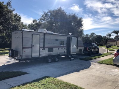

Went to the trailer today to give it a once over and the more I look at that factory storage platform the more I think it’s a good idea with negative results.
Going to remove and solid mount the spare to the rear bumper and do a hitch mounted bike rack for the family bikes.

1805D95C-13E3-4344-89D0-7A6EB4C6AE1C.jpeg I do need to take it in and get a fully accurate weight. I have been guessing on the highsides for everything. Only one battery and spec says 612 hitch weight dry. I don’t ride with full water. And load on the front storage on the trailer is maybe 50lbs of tools/gear + 2 propane tanks. I try and keep the storage well ballasted with the rear
I really think removing the jostling storage rack and spare tire will make a difference.
Attached is the only picture I have of the set-up. But if you zoom in you can see it’s held with hitch pins. Imagine that turned parallel with the ground re-hitched pinnned on either side. imagine that bounce.
