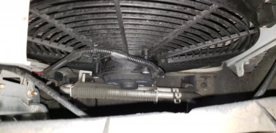

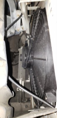

My 2004 XLT is an old police commander's unit. It came with a pusher fan on it with an switch mounted below the headlight switch.
With that fan on and at highway speeds, it's Antarctica, even in South Texas heat.
Can you post a pic of this pusher setup? Kinda curious
At highway speed, that electric fan isn’t doing any good.
