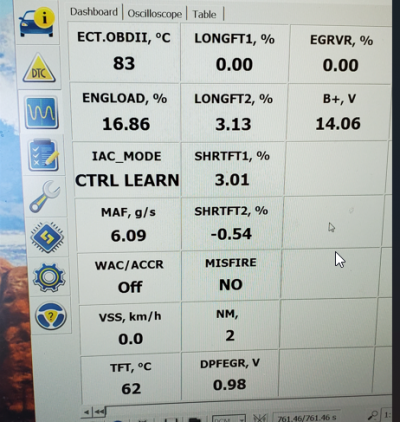

Before anyone assumes faulty new parts, take a look at this live data screenshot below. Note the short- & long term fuel are well within the +/- 10% range and look really good. To my understanding, this pretty much eliminates even a small vacuum leak the smoke test might have missed. Also: there are no misfires, so I'm not sure there's a problem with the coils.
