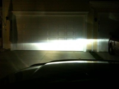

I'm going to try and take a pic of the truck today so you can see them.

I don't know what a picture of the light cutoff would do. It's totally subjective anyway. I can tell you I live in a rural area (farm country on MD's Eastern Shore). I leave at 4:00am for work. It's dark. Even with the standard light output (before I added the HID a few days later) I was happy with these. Like I said, I had to aim them up slightly, but that was to be expected. I seriously doubt the hardworking Tawaiinese folks who made these have an Expy that they test the aim out on every set they build. So, I figured a little adjustment would be needed. Overall, quality is decent, fit and finish are pretty good (same lines/gaps as the factory ones) and I liked that these were true "plug and play". I really like that they are a flat black finish. I think once I get my tan trim and upper/lower grills painted black, these will really add to that look I want.
