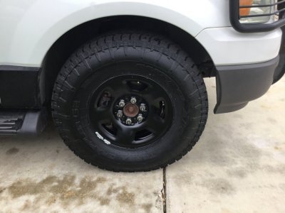

as I said, 285/75/17 on an 04 XLT 4WD SSV. no rubbing at full lock either direction. no cutting necessary.
I will adjust speedo when I install the tuner, tomorrow.
