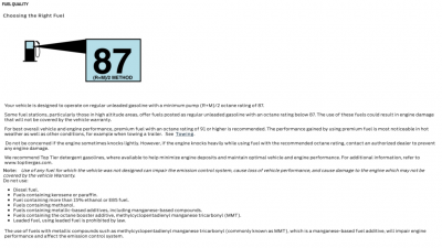

I wasn't aware there was a flex-fuel option (3.5L, '18-'20).
E85 is gubermint subsidized - hence the artificially low price.
These days all fuel is e10 unless you can find/buy the ethanol free stuff (bu-cees carries it in lots of location).
From the '20 owners manual....
