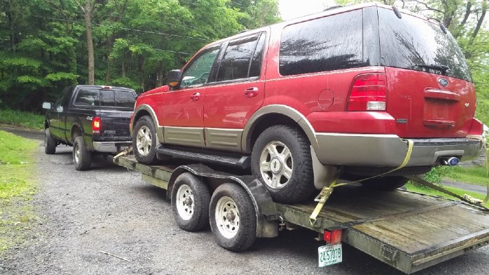

Well, haha, I think it's the cats. Expy decided he was going to throw one of the rear spark plugs out of itself, so since my insurance came with towing, he's at the mechanic and he'll be seen on Monday. All I did was try to start it, and POP!

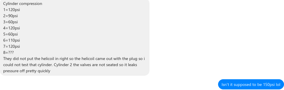

So! Turns out a good bit of my power loss has to do with Cylinder 1 having 50psi of compression instead of 100psi. Anyone got a 2003 5.4L Triton V8 for about $600?
I might as well never buy a car again, I overpaid on a 98 explorer that proceeded to have way-too-expensive-to-fix timing chain problems after a year, and now my expedition, after one year, the fancy vehicle that was supposed to be good, needs a whole new engine that I can certainly afford with the $600 I have saved, right?

Actually normal compression should be around 140-150 psi for all eight cylinders in your SUV. Sorry to hear your problem is so severe. Bummer buddy. Now you see what I was talking about in my earlier post about cats. Are you having any top end noise? Most common problems are a worn rocker, or stuck lifter. Either way, you or the shop would have to determine if your compression loss is a valve or bad rings. Here's a Hail Mary pass you can try. Pour about 16 oz of Marvel mystery oil in your oil. If you have sticky rings, or something stuck in the top end, it might bust it loose. Again it's very doubtful it will work, but what have you got to lose. You don't have cam phasers or solenoids to worry about, so you'll only be out about $7.00 or so. I had a nagging feeling a year back when you were thinking about this vehicle, that car lot wasn't being honest. Especially at the premium price you paid, but theirs nasty people in this world, and you found one of them!
I agree on the Marvel however 16oz is not going to do much. He needs to replace 2 quarts of oil with Marvel, and yes I have had good luck with the stuff in both crank case oil and in the fuel.
