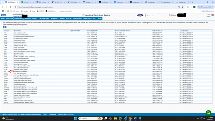

WAL (walk away locking) was only available in the Ford EV's 21 and up at first, and was introduced to the F150 and Mustang starting 2024. It would require the vehicle having an RFA module for it to work. Enabling the config in the BCM with FORScan alone won't activate it.....the vehicle would need to have specific hardware for it to work. In the case of the Lightning/Mach E, it required the BCM being updated to a certain software version before it worked even with the RFA module already in there from factory.
It does not seem like any Expos 2024 and under have an RFA. I was able to find the VIN of a 2025 Expo Platinum that already came off the assembly line, and this one DOES show it has an RFA in it. Seems like only 2025+ Expos will have this feature.
