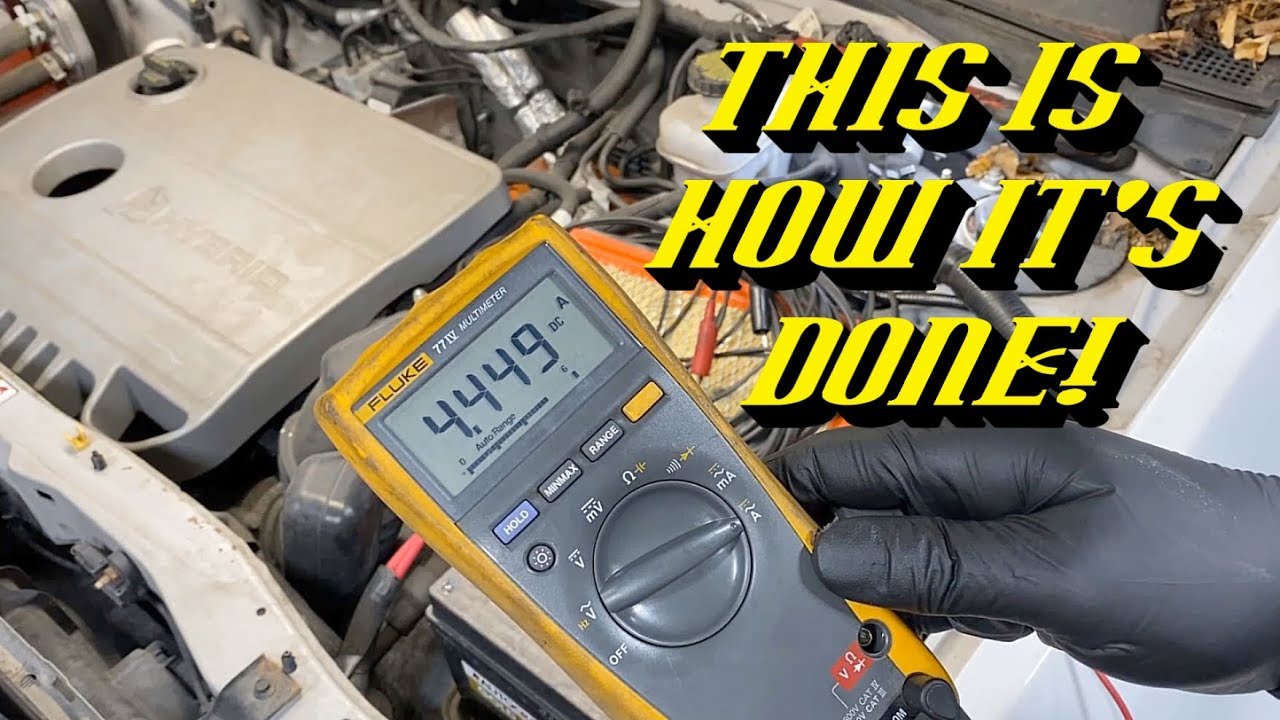

with the car off and doors closed for at least 30 minutes remove the positive lead from the battery. put a multi-meter between the positive post and the lead, start with the 10 amp scale as a precaution. There are some capacitors that may take a few seconds to charge but the reading should stabilize below 0.1 amps. If the draw is less than 0.1 amps go to the lower reading scale for a more accurate reading. If you are above 0.1 amps you need to figure out which circuit is causing the drain. I usually start by pulling fuses for the each of the light circuits.

Take the battery to a local auto parts store and get it charged overnight
Then do a parasitic drain test. Requires the battery to be installed for about an hour before doing. I performed my test with a $6 Harbor Freight multimeter
My drain was Fuse 37 in the engine compartment. Still haven’t figured out the actual problem but I pull the fuse when the truck is sitting
