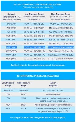

I do have a set of a/c gauges.yesterday it was 95 when I checked the pressure.25 on the low side and 15 on high side.
That's not right Your low side can't be higher than your high side.
These are pressures for an average 134a system, not necessarily for the Expedition, but this will get you in the ballpark.

From the readings your getting you've got no freon or other problems brother!

You either have an issue with the gauges or the orifice tube. Since the system isn't running both the high side and low sides should have equalized by now - and be at the same pressure.
What brand of gauges did you use?
