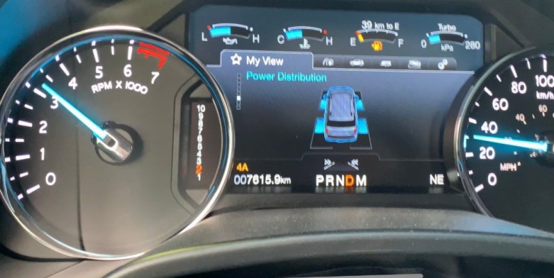

I just took this picture. 30km/h, dry pavement, turning a corner, quarter throttle or less. Front wheels are engaged.

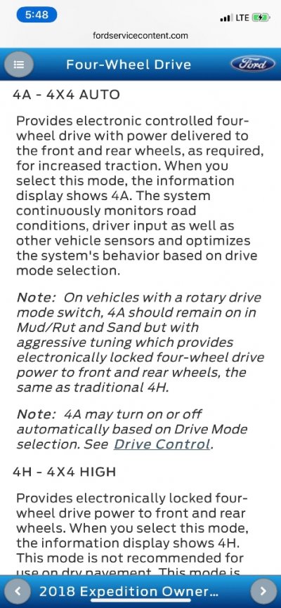

Here is the page out of the manual. No where does it state that power is rear only until the wheels slip. It simply says it varies the power.

My 3rd gen owners manual states the same, still can’t change physics. 4WD provides no additional traction when braking or turning...I highly doubt these trucks are running down the road in 4WD on dry pavement. Would wear driveline components and drastically reduce MPG, not to mention serious binding when turning in the front end. I kind of question the accuracy of the display.
Here is the excerpt from an 07’ manual:

So you can see the power distribution to each wheel?? That’s cool, I’m jealous!
