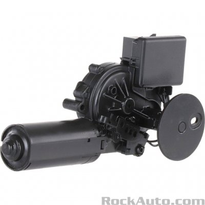

Big thanks to those that replied. I found my power draw. Rear wiper transmission (the unit that attaches to the wiper) was extremely dirty and wouldn't let the wiper turn. The motor that drives it was not in home position and was on constantly. An afternoon of cleaning and reassembly resolved the issue.
An easy way to verify is to pop open the rear glass. When I did this the motor returned to home position as there was no load on the motor.
