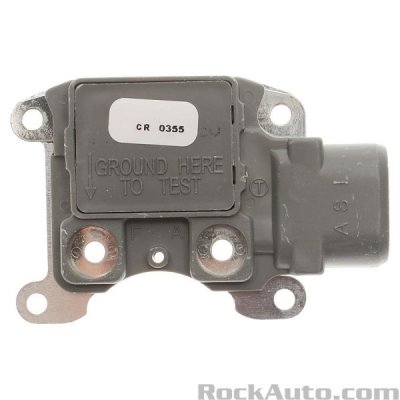

Are there any autoparts stores you can get to where you are ? If the alternator is otherwise alright you can probably get away with just changing out the voltage regulator on the backside for about $50. It's external and just has 4 screws holding it on. Otherwise I'd say, yeah, go for the new alternator.
Standard Motor Products VR455 ....

I've thought that too - any voltage regulator I've had go out caused an overcharge condition, though. But then that was on a whole different machine, too. If the alternator checks out okay, I'm more than likely still gonna put a new voltage regulator on it.
