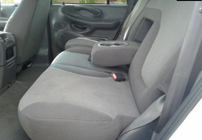

^ 2001 Eddie Bauer (looks like a bench to me!)
Can awesome folks here shed some light before I get into this project? Is there really a difference in floor mounts in 2001 between the above pictured bench, verses bucket seats? After which, my questions above become important. Thanks!

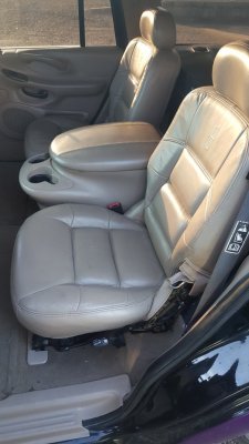

Post a picture of your buckets in your truck never seen one. In 2003 they started making the second row into three seats, two side benches and a jump seat in the middle. I'm thinking it's custom / transplanted into your truck. Are the seat designs different front to middle to back? It would be noticeable unless they changed them all. If the center of the back rest looks square those are 03 seats. Look at your carpet for extra holes for the bench seat especially in the middle. I thinking like six holes for the jump seat alone. The buckets have to be at least four holes. On the 01 there should only be 8 square holes. Unless they made a custom or transplanted the rug too.

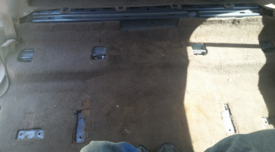

I've looked at a dizzying amount of 97-02 Expeditions only to conclude that this is NOT a direct swap to go from Bucket to Bench or vice-versa. Dang it. The floor body is the same, but the bolts and more importantly BRACKETS are NOT the same - no bench utilizes the same mounts as the buckets. There are clearly places where they would go, but simply aren't there (factory differences).
Basically, it seems the bucket setup is like the right hand-seat, mirrored over to the left (as opposed to the left side being a wide 60 of a 60/40 split). See below, the mounts of my buckets match those of the right hand "40" part of the 60/40 split:
^ Bucket seat, locking clips in the back, and 3 bolts in front (horizontal foot pattern on the right)
^ Bucket seat from behind, the two locking latches/clips
Now see the floor, literally a mirror of what you see on the right bucket is a mirror for the let bucket match of the pair.

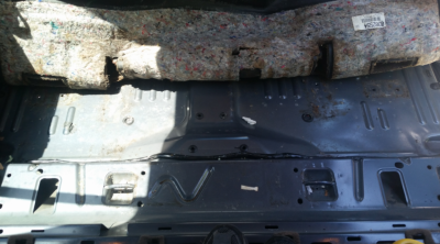

^ Floor, pic taken sitting in front seat aiming toward the back. Notice TWO sets of bucket seats, mirrored. The left is similar/identical to the "40" of the 60/40 split bench.
IMPORTANT: what most critical thing missing is the vertical bracket for the wide seat latch. Look at the 4 horizontal brackets here, above the 3rd one over is the metal frame, and you can see a flat spot where a vertical bracket WOULD be welded in for the "60" part of the 60/40 bench.
And finally, with the carpet pulled back, you can see that the floor is the same as all ya'lls bench setups, except that the single vertical locking bracket for the "60" wide left hand side of the bench is missing, and the two horizontal brackets for a bucket are there. And the bolt near the center ridge where the wide seat (left hand seat) would bolt in.

^ Carpet pulled back, this pic is taken from the rear facing forward. Note the bolt holes on the right are similar/identical to the "40" of the 60/40 split, BUT that same pattern wont work for the wide seat that would sit on the left here! On the left is yet another bucket i this case.
It's factory. Mine's the same way. 2001 EB Premier (all black, trim & all). I think the captains was part of the 'Premier' package.

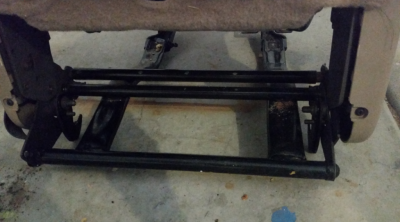

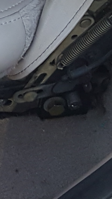

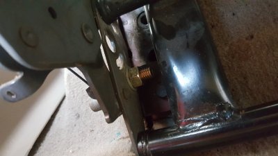

@BaggedExpy That attatement didn't come through. Can you fix it? I'd actually like to see what sort of mod you did there. It sounds like you modified the seat to fit the floor, not the floor to fit the seat. That would be much more doable IMO.

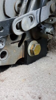

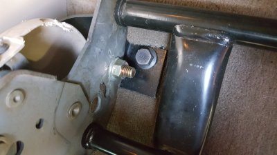

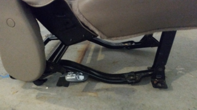

You DO NOT need to cut amd weld the floor.. who would actually do that lol ? Heres mine. I took my rear driver side seat apart. Took hooks off and other crap i cant use. The test fitted seat to find the best spot to drill holes.. basically i used the stock bolt holes ( closest to door) to bolt down the left side of seat. Then drilled two holes for the right side of seat track.. bolted angle iron to seat loosely then bolted to floor then tightened the ever living crap out of those bolts... no cutting of floor or welding. Hope i kinda helped
Also harley davidson seats fit too. Those are what ive been looking for but found navi seats way cheaper..
Dr side rear seat bolted to stock
Dr side rear track
Dr side inner seat track. ( closest to center )

@BaggedExpy So you went from bench (your floor was set up for bench?) to buckets, and you modified the buckets to bolt down instead of latch in. Is that right?
I have the opposite problem, and nothing to bolt to (only latches on the floor). Might be quite the engineering mod on a bench seat to get it to latch in where the bucket does.

Yes but i only had to make brackets for the driver side rear. My pass side used the same floor latch as stock
