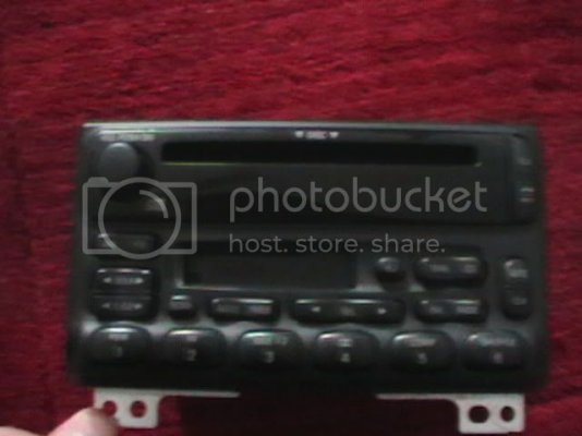

this is what I had before
I put in a touchscreen navigation unit, with backup camera
M
mikegigabyte
Jul 4, 2009
100
san diego
I guess yours was the cd changer?
here is the back side, I ordered the navigation unit from crutchfield, and was excited because they sent an adapter then when it came it was way different. They sent me the website for the pin diagram so then I had to cut it all out and butt splice everything, its a big mess inside but its holding up for about a yer now. they told me I have 04 harness
the wide plug had all the circuits in it, the small plug was never used for my application

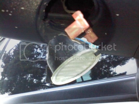

here is a pic of my puddle light, as you can see its slid plastic with only a removable lens somehow
ignore the blue tape I put that on there
Did you figure out how to remove the lens or is it not removable? My 2007 has the same type (at least it looks like it based on your pic). I have replaced all of my lights with LEDs (including the parking, turn and brake lights) but was not sure if the bulbs were replaceable in the puddle housing.

when all my led's come in from china I will attempt to remove the lens, either by blade or heat. I just want to make sure I have the correct lamp first. Im guessing I can glue it back on. Sucks its like that, and im praying I dont break it.

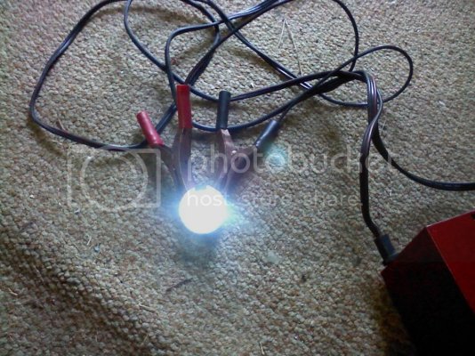

looks like my puddle light led's came in today. Not sure if I will attempt them yet. Some reason they look fatter then I thought, so im going to have to check to see if these are for the puddle lights or wait until the other order comes in with all my interior dome led's
either way even if I have to solder them in I will use them, the only hassle will be trying to get the puddle light open somehow without ruining them.

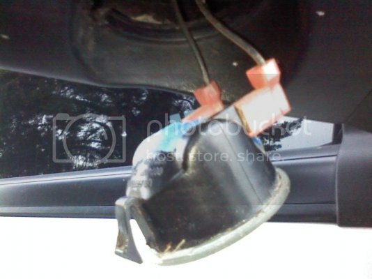

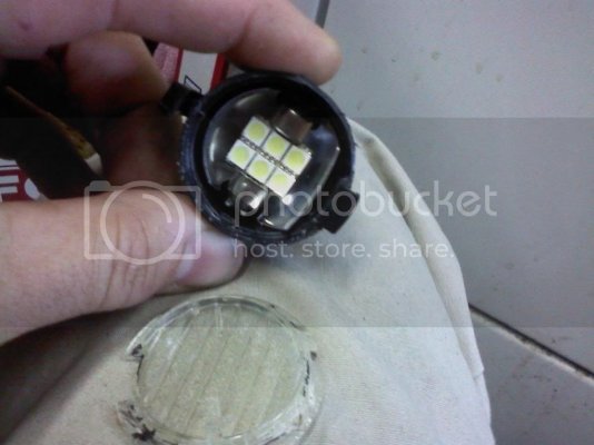

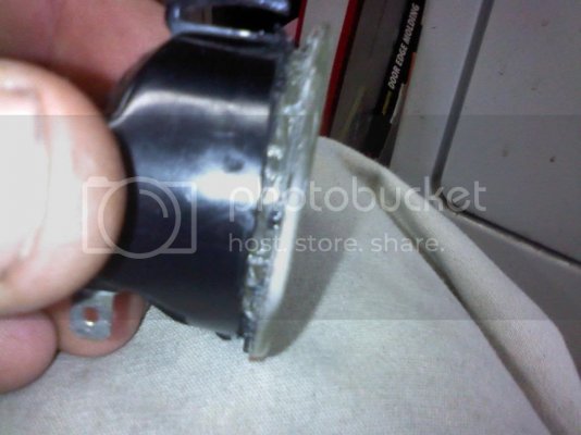

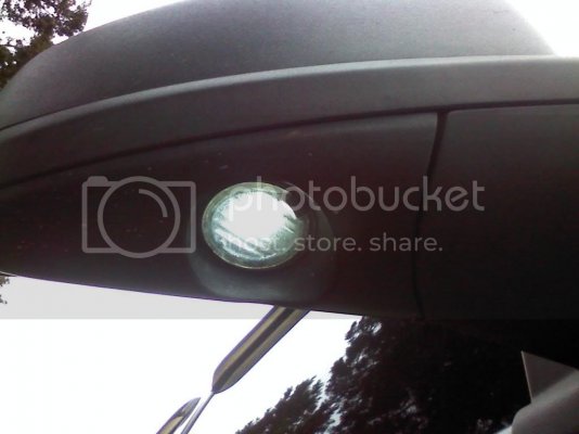

Small update...

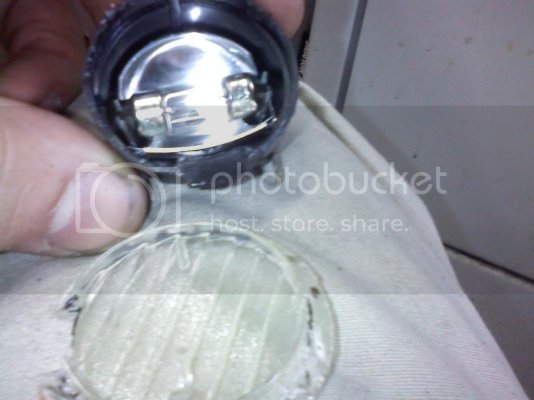

Took apart the puddle lights, its very easy to do now that I know how. At first I tried heat gun, then razor blade but nothing. I then saw through the lens that it has an internal ring. So last resort dremmel with those thin cheap cut off wheels. I melted the black housing all the way around, then used a small awl and popped the lens off. At first this was very hard, second light went very fast so its really easy now.
Here are some pics
Here is the cut and the lens popping out
Inside shot, note lens has plastic feet that pop down to help hold in bulb
LED installed, slight angle to shoot light away from door
Daytime view
I used super glue to put on the lens, and I will also go around the outside too just to make certain its all glued in. Im guessing the black housing is abs, and even though I have abs super glue I used the regular stuff because im not sure what the lens is made from.

checked them out tonight, look good. Have more light hitting the door then what I would like but its too late to do anything about that. Very bright and white and lights up good. one day I will try to get a night pic
Also they fade off so im guessing the inside ones will too, which is cool

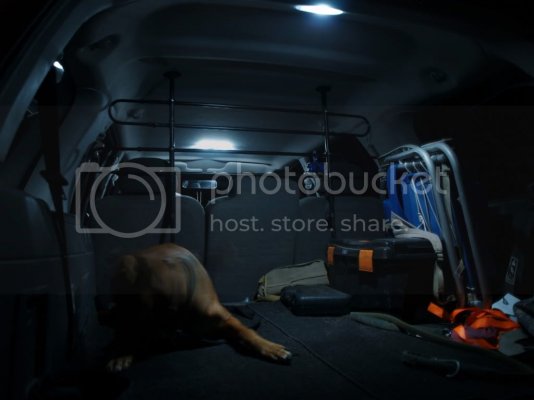

Well all my dome light led's came in today so hopefully later tonight I can get them installed. I may attempt to take a pic using a good camera and tripod no flash so maybe it will have a long shutter speed and show the most light.
M
mikegigabyte
Jul 4, 2009
100
san diego
Got the lights installed. The domes arent as white as my puddle and license plate but they look good. Slight blue tint but more on the white side.
Some reason the puddle light pic looks green, but its white
But you can tell the light color difference in the pics
I found this pic, I think the camera added more blue in the other images, this pic looks whiter
In real life it looks really good and crisp light. Also I had the map lights on too
