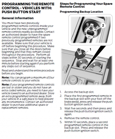

Yes, there's a hole under the front cupholder for programming your key. I can't help you with cleaning it. Seems like poor design choice, but I'm not a vehicle engineer.
From the 2024 owners manual:
