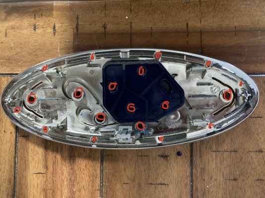

So I decided to color match the emblems on my 2020 F150 (yes I know, not an expedition but I’ll be doing this on my 2016 expedition here soon). Process is pretty straight forward. Once you remove the emblems, you’ll turn it over and find about 19 plastic lips that you will I’ll need to either grind off or cut off. They are pictured in red below.

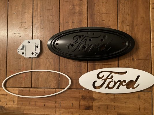

This will allow you to separate the pieces of the emblem. I used a drill bit and a pair of wire snips. You will end up with this…
Pick your colors are paint away. I chose to to the blue in gloss white and the chrome in satin black to match my F150 tailgate letter inserts. Everything is drying right now so I’ll post final pics tomorrow when the emblem is back together.
