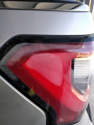

Condensation in light assembly. Normal?

Noticed this a couple weeks back. Condensation in both tail lights. Should I be concerned?
6,531
3,140
It's nothing to be concerned about. If the seals start leaking like crazy and you get water droplets inside the dealer should fix under warranty. Usually Ford doesn't get bad headlights and taillights like BMW. Mine are over ten years old and still have no fading or moisture inside. If the temp and humidity is just right this can occasionally happen on any vehicle.

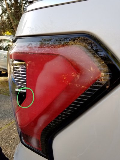

Yep, totally normal. Actually, if you look right here, there’s a little hole in the plexiglass. I thought it was a defect or damage until I saw it was on both sides and read in the manual what edizzle mentioned. a1a0d67c6f0e1f5bc63f2502dd0b46ed.jpg

That’s not a hole, it’s a divot left over from the manufacturing process that someone at Ford saved a couple pennies per lense by using a single injection port in the center of the mold vs multiple ones around the entire perimeter. The vent is on he back side of the assembly.
Ha! You are correct (although I did have to confirm) and I feel dumb. Oh well, it happens occasionally.

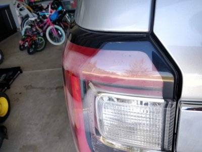

View attachment 38491 View attachment 38492 View attachment 38491 View attachment 38492 Second owner of my 2018 Limited. Usually happens after a wash. Unfortunately sitting at 40,000 miles so I'm past the bumper to bumper. Ford dealership wants me to bring it in when it happens again for them to look for hairline cracks. Hopefully I can talk them into replacing because when the moisture is present it becomes a safety hazard because the brake light stops working. View attachment 38491 View attachment 38492
