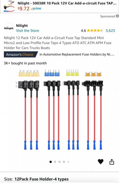

Personally, I wouldn’t tap into anything. Just in case there’s an issue with the camera it won’t take out something else with it. I’d give it its own source of power; keeping it isolated. Here’s one example…
I’d run the wiring along the headliner/ top of windshield, then down the windshield pillar to the fuse box. Wire the camera up to the jumper. Plug in the fuse and jumper. Done.
Agree, though I would not recommend buying those online. Assuming you have an auto parts store within 15 minutes, just go drive over and get a few. Supports your local economy and avoids risk of fire from cheaply-made electrical stuff.
