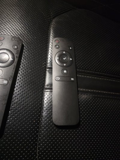

They have remotes for them. Should be able to order from Ford.
They however cannot be controlled from front system.

Ya the ford sync system is completely separate from the rear seat system.
There is the mirroring app mentioned but I personally didn't like it.
I installed an SD card with tons of movies and shows and let the kids pick with remote.
