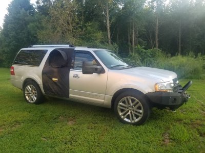

I sleep in mine often because of where I work. I throw a single mattress in the back and it's pretty comfortable. I had it on a fold up frame, but I found it wasn't necessary and put me closer to the roof than I wanted to be.
I cut ~1/16" plastic sheets in the shape of my five rear windows and painted them flat black. They pop in and out easily. I also made a curtain that hangs on a fiberglass rod that hangs just behind the front seats. It basically blacks everything out looking in and out even under lights. Nothing looks odd from the outside. It just looks like an Expy with dark tint.
I'm almost 6', 240 lbs and it's still comfortable....
