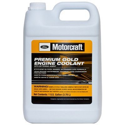

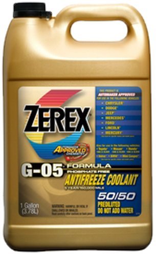

Total system capacity is 21 quarts, or 5.25 gallons. Use Motorcraft Premium Gold or Zerex G-05 coolant. Not that green Prestone crap.
