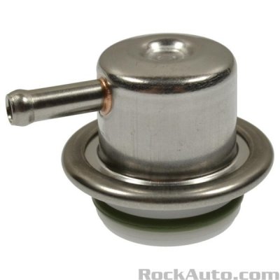

So I ran into a little problem. So my FPR is on my fuel rails. I came to autozone to buy a new one and it says in their system that its not serviceable comes with fuel pump. So how will I go about finding a new one thats the right one and a fuel pump aswell. I have the early model 2003 eddie bauer. Would a 2002 FPR and Fuel Pump work on mine?

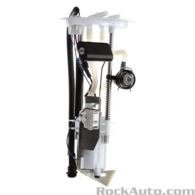

That small one on the fuel rail is a pressure damper, but not the actual pressure "regulator" for the fuel system ( it's retained by a big snap ring....). The actual pressure regulator is in fact part of the fuel pump assembly, but external to the fuel pump. If you look at the fuel pump assembly you'll see the lines passing through it.

Ahhh ok I see, then thats the next thing. That should solve my problem. Man almost 400 for a new pump. Gonna probably replace it in a week or 2
