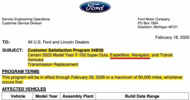

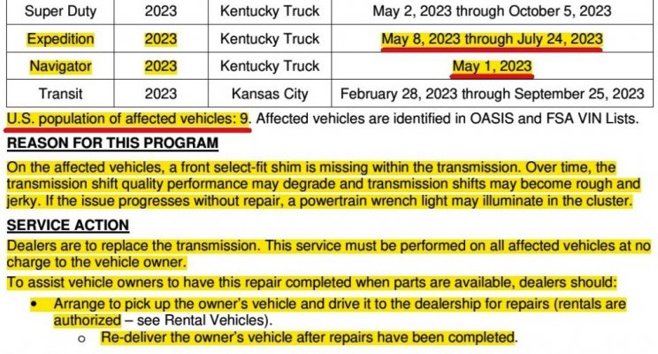

Nine VINs across four Product Lines, with a surprisingly broad span of Build Dates except for the single-date Navigator, a somewhat commonly presented symptom, no unique teardown or diagnostic Service procedure -- just "Transmission Replacement".
If your vehicle falls within the Build Dates and is showing the symptom(s), your dealer can use OASIS and your VIN to determine if CSP 24B59 applies...
