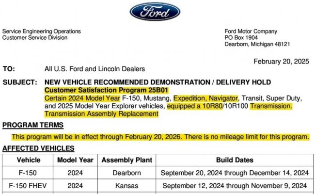

Customer Satisfaction Program 25B01 - Certain 2024 Expedition/Navigator vehicles - Equipped with 10R80 Transmission - Transmission Replacement

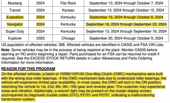

How in the *** do you assemble it with the wrong size bearings??? Geez, and just when I was thinking that maybe by 2024 they'd worked all the kinks out of these transmissions. Maybe 2025 is the golden year?

It's possible that the supplier put the wrong bearings in the right boxes and the assemblers in the transmission plant used the parts they were provided.
Stuff happens. Note that Ford believes that only 398 vehicles are affected out of the thousands of vehicles built in that time frame.

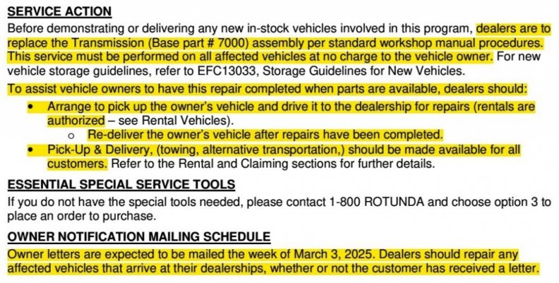

Unfortunately, the 2024 Expedition MAX Limited that I bought a week ago (and love), shows it was made 10/24. I couldn't find an exact manufacturing date on the door sticker nor the window sticker so, I am guessing I must call Ford directly to find out if my Expedition VIN is included in the 398 junk ones. I am hoping NOT! I dread the thought of having some inexperienced dealership trans mechanic butcher up our car or forget something, while replacing this trans, so that we'll end up having a totally UNDEPENDABLE Expedition for the next 10 years. Very worrisome!

This kind of thing (that likely was a sprag supplier issue) is why it is critical to focus on quality. When these happen, it should be peoples' default reaction to say, "Hmm, I'm glad Ford found the issue with only a few hundred affected units," and not "JFC, what is it this time?" Anyone know if anyone at all in Ford management has ever lost a job over all these issues?

This is an different issue from the CDF drum issues that afflicted earlier 10R80 transmissions.
And, the bearing issue identified here affects less than 400 vehicles across multiple product lines.

Did you read the TSB? The issues fixed were design issues, such as the CDF drum, which "Should" be fixed. This was a mistake in the assembly process, something completely different and could happen at any time when you aren't focusing on quality.

You dread the thought of a dealership tech swapping out the transmission but you are ok with the factory tech who somehow let the wrong size bearings get in, to do the work? Unfortunately, due to Ford's lack of quality, those dealership transmission technicians are pretty experienced due to having to pull, rebuild and reinstall transmissions all day every day. Seems like a swap would be a simple job for them at this point.

Yes GixxerJasen, you may be right about the dealer trans mechanics learning well from constant immersion in these transmission & overhauls. I had NOT thought of that. And, NO, I am NOT OK with the factory tech letting the wrong size bearing slip in but, in their defense, if they are on an assembly line and given parts to assemble a trans with (especially an 'undersize' bearing that wouldn't jam things up), they may have never known they were installing the wrong part! Ford's QC manager in that Department is the one who should be responsible for taking 1/100th samples and checking those sample parts dimensionally, it seems to me.
Anyway, last night I looked at our 1-week-old, 2024 Expedition Limited MAX door VIN tag and it only said 10/24 date of mfg. (NO exact mfg. date). I was worried!
I called Ford Customer Service at (800) 392-3673 and spoke with a very nice lady there. She looked up our VIN and said our Expedition was, in fact made at the Kentucky Plant on 10/2/2024, right within the timeframe window. Once she put our VIN into their system, it came back as NOT included in the 398 bad ones. I asked her how that could be considering that our car was within the timeframe window? She said she didn't know for sure but, that some of the October built defective ones were caught at the Kentucky Plant before they left the lot and, were repaired there before being shipped out to the dealers. I am sure hoping that is the case with our Expedition! Our Expedition only has 376 miles on it, and I have no idea how long it takes for a "BAD" trans to fail?? In our case, I hope it is NEVER.
