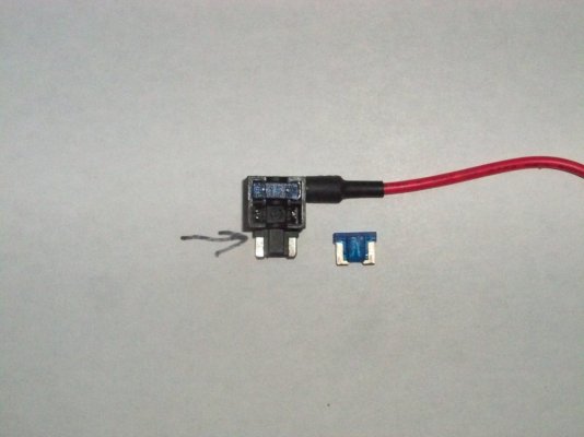

Well, for those who can install a dash cam without roadblocks my hat's off to you. Seems I'm always running into something. Trying to hook up my fuse taps to the fuse box. I'm finding that the fuses are recessed in the box and the fuse tap will not reach deep enough to seat, really even make significant contact. I have a multiple taps and none will work. I'm sure someone else has run into this. The photo is the style of fuse and tap that was provided with the camera. I checked local shops. Auto Zone, etc, they just scratch their heads. There must be a simple solution.
I think I solved my problem. I just used the next size up, had to file the sides down a little bit to fit. Used the same amp fuse just a little larger.
I ran into the exact same issue with the cameras I bought for our cars. The designated tap which matched my fuses did not work. Luckily the kit came with 4 different sizes and I found one with longer 'legs' which allowed it to plug fully into the fuse panel.
