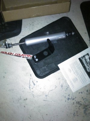

Got the steering stebilizer today now tomorrow to 4wheel parts to get aligned. And see how much they will charge to install it for me. If not I will.
Keep you guys posted
