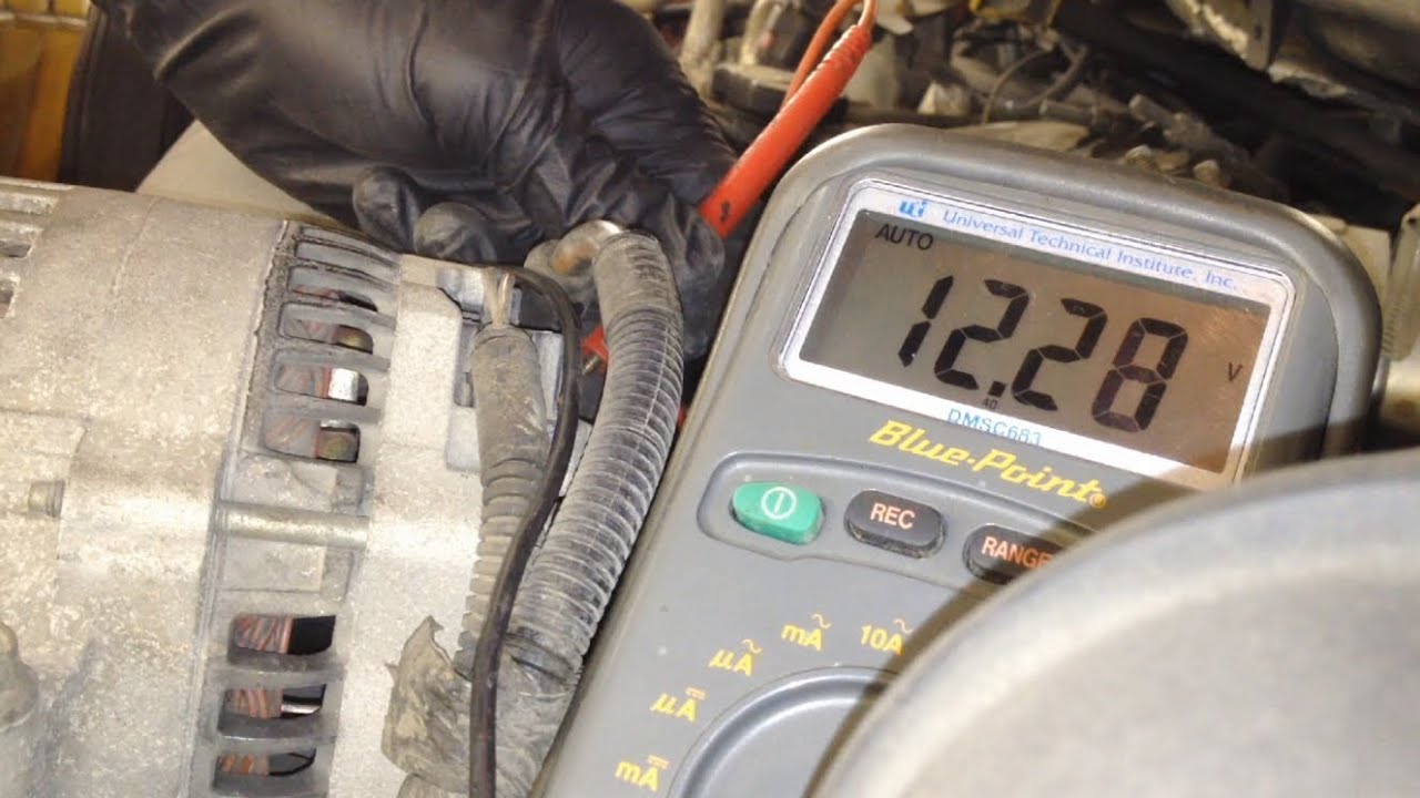

FTM has a good video on this. He mentions unplugging the connector on the alternator and checking if the battery light changes.
I ended up having to replace my voltage regulator.
The alternator grounds thru the engine block. So does the starter, check resistance of engine ground.
