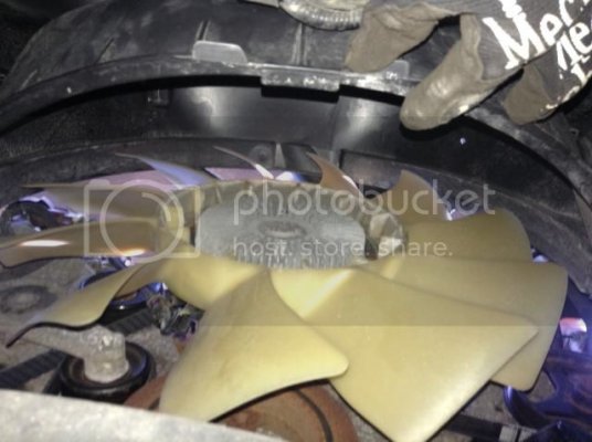

I was changing the serpentine belt today and found something I've never heard anyone talk about. I was trying to get the belt on the lower pulleys and trying to reach around the lower fan shroud. First I noticed that it felt loose. I found that there are holes on the both edges that should have had a plastic retainer pin in. Both are gone. I don't know how long they have been gone. When I went to see if that is going to be a problem. The lower fan shroud is hinged. It pivoted up out of the way and made getting to the belt a piece of cake. I also noticed the oil filter is easy to get at with the shroud up and out of the way.

The bottom of the shroud comes off on 04's atleast. Makes pulling the shroud very easy. Off course mine is all the way off for the e-fans.
