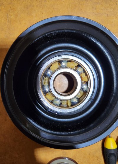

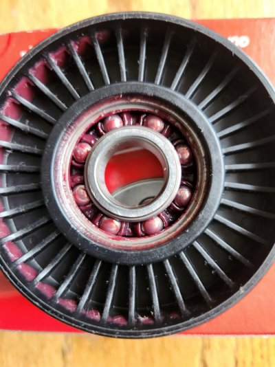

Well I really didn't intend to update this thread again, but I found this very interesting and took some pics.
I have 2 pics of the grooved idler pulley when new. One shows the pulley, backside of the seal and the 2 jewelers screwdrivers I used. The larger screwdriver I used to pull the seal out and remove most of the grease, the smaller one got in small spaces better for grease removal. The other pic is a close up to show the amount of grease in this one.
I also have 2 pics of the Motorcraft tensioner and pulley. Last weekend I had cleaned the old grease out, not much and it seemed burnt, and then greased it since I needed to run it another 350 miles or so. The pulley has 41k miles on it and it's a bit loose so it's been replaced. Here's what I found on the old pulley upon removal which is what I found so interesting and thought I'd share. One pic shows the tensioner as it came off with grease slung on it and inside the pulley. The other pic shows how much grease had been slung out.
It appears you can put too much grease in. On the replacements I installed today I filled them with grease and then wiped out enough to expose a bit of the bearings. So far that seems okay, but we'll find out over the next week.

So it appears that it wasn't really the amount of grease I had put into the pulley bearings that made it sling out. Instead it was because I has only wiped the seal seats, which must have left a very thin coating of grease allowing the seals to slide out a bit. After I carefully cleaned the seals and seal seats in the bearing with brake cleaner they have held the grease in just fine.

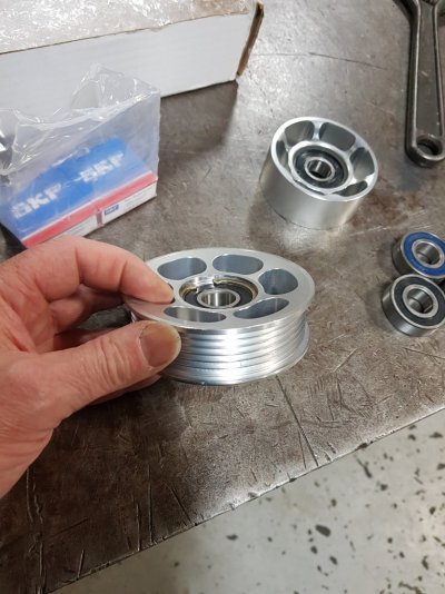

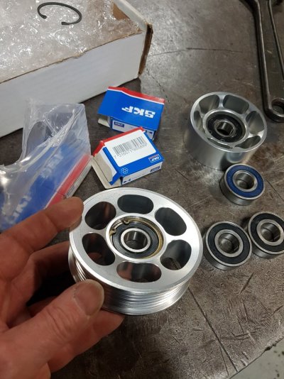

I just came across this thread. I am not sure if anyone is looking here but I will update anyway.
First I am going back in time a little, and since I traded in my 2014 Expedition, I have no more images to show then the attached images below. I did make a video that I could post on YouTube.... maybe I will do that. I don't see an option to upload videos here.
Note: The stock pulleys from nearly any supplier are inferior. The bearings are complete trash. I bought brand new billet pulleys for my upgrade and pushed out the stock bearings which were a generic China brand and then I installed a much better SKF (possibly made in China but QC'd by SKF). You could easily tell the difference between the two bearings. And there was obvious visible difference between the stock FoMoCo pulley bearings and the SKF.
Anyway, bearings are typically a standard size and it is often easy to upgrade Any bearing, it is just the work to change them out that might stop you.
On these pulleys I also upgraded the snap ring to Stainless Steel.
If I find more images on this subject I will update this post.
By the way....my serpentine belt was near silent after the bearing upgrade.

Wow those pulley's really look nice. Having a snap ring is sweet, should make swapping the bearing fairly easy.
Good bearings can make a major difference. I did briefly considered changing the bearings as the bearings in each pulley have too much play. With the original grease removed it was easy to feel and see. I had not considered looking for billet pulley's, they should have basically no runout.
Thanks, this is something to look into for a more permanent resolution.

I used our press at the shop to change out the bearings. If you don't have an arbor press or hydraulic press, try using a large drill press and make something that you can chuck up that will be just under-size of the bearing outer race OD.
Just changing the bearings on the stock pulleys would make a difference, but I agree that the billet pulleys look awesome when you are done.
