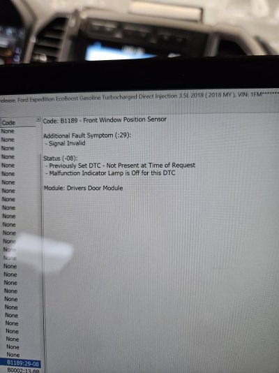

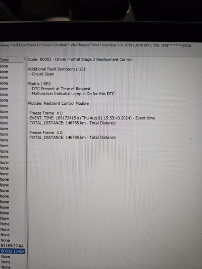

Each time the town is pressed, it rises and falls an inch at a timeThe glass position sensor is probably in the window motor. Does the express up and down work? If so I wouldn't worry about the code. The SRS code could be a number of things but I'm guessing a clock spring since it's the driver front. I've seen similar codes before when I was a tech.
Here is the recall notice. I don't know if it applies to you or not, but worth looking into.2018
That means if i want to Close the glass once, press the button at least 10 timesEach time the town is pressed, it rises and falls an inch at a time
driver airbag light onWhat does the malfunction indicator lamp look like?
There is a recall for safety belt tensioners that can explode. What year is your Expedition.
You need to contact your dealer. I had the same thing twice, once for each side. The pretensioner safety switch is shorted and will eventually explode in the vehicle, making a very loud shotgun sound. The seatbelt will be stuck and not be able to use once retracted. If your vehicle meets the recall it is a free repair. I would not hesitate, as once the fault message appears, it is only a matter of time when it blows.driver airbag light on
