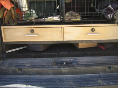

has anyone else built a drawer storage unit for their Expedition ? I just finished mine, I built mine for road trips that we love to take ! Two drawers and a lift up door on the front, and I have two dog crates that strap on top, and still have plenty of room for everything else we need to take.

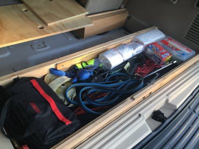

The top and bottom are 3/4” plywood, 4’x4’, the sides, back and the middle are 1x6 pine boards , the drawer sides and front and back are also 1x6 pine trimmed down to fit inside, the bottom of the drawers is 1/4 inch plywood, the slides are 24” self closing. I do have it mounted with two “L” brackets that are bolted to the floor where another bracket is mounted, under the carpet that’s in the rear storage area, on each side, about 14 “ from the back of the cargo area, the bracket that’s there goes under the side panel on each side. I trimmed my sides and middle 3/4” on the front so the front of the drawers would counter sink into the box, ( the front of the drawers sets flush with the box ) I’ll take some more pics !

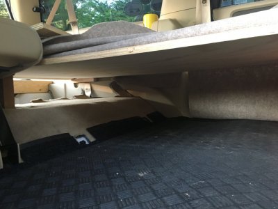

I made this one last year, it's for a specific purpose. Works well, but I didn't need drawers for this project. With the hatch shut it's completely hidden. It's 5 inches tall and and cable locked through the 2 row seat brackets. Mini truck bed mat on top, cut down to fit.20170320_144140.jpg 20170320_144108.jpg
