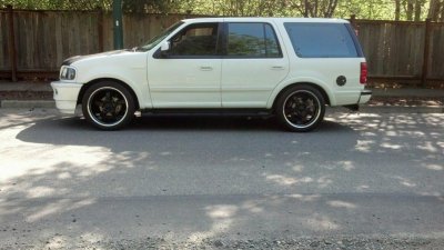

I do! I believe they where only 250 on ebay for all four. I didnt use the pads tho because they like to get my wheels dirty so i bought the best pads the autopart store had. not sure if you can see them in this pic but they are there
