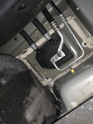

Noticed a steady drip just behind the right rear tire. Seems to be water, is this from the rear ac?

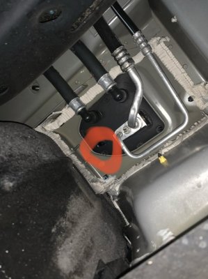

Rear evaporator drain. No compressor at rear unless you take it to Midas for repairs.
10-4. Thought it was a compressor. Learned something new. Either way, still completely normal.

If it ain't shedding water, it ain't working right. I added a short 3-4" hose on mine since we have potter wasps that live to plug up any holes to lay eggs.
