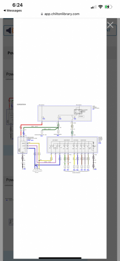

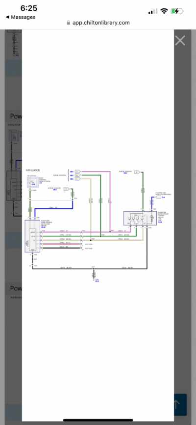

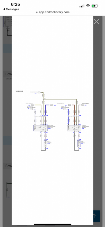

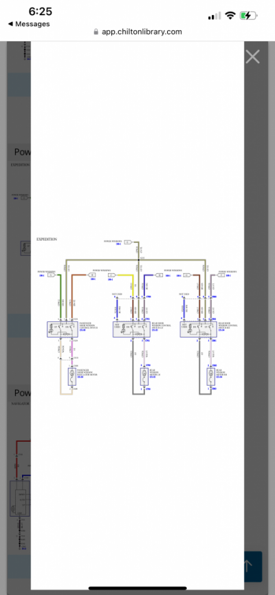

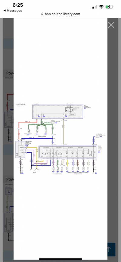

So I just had (on my 2015 Expedition EL Platinum) this issue pop up where the driver window and both the rear power vents stopped working at the exact same time. Unfortunately the rear power vents are open and will not shut. I use them quite frequently and have never noticed any wear or bad noises coming form either. Has anyone ever had an issue like this? Or does anyone know if those 2 circuits intersect somewhere? I have not been able to bring up a good wiring diagram that shows any connection between these 2. I am also looking for a wiring diagram for the plug on the front window motor because there is many wires on there. Any help would be greatly appreciated. This issue came up suddenly and there where no warning signs, the only thing I have done recently is install LED head lights. Could this be the cause? I remember I had a 2010 explorer I once put LED tail lights in and burnt out the airbag control module. Edit I also forgot I have an o2 sens code that popped around the same time not sure if that could be connected.

Give this a shot. Not sure if those other symptoms are related… theoretically they shouldn’t be. If so, and you need wiring diagrams for those circuits, let me know.

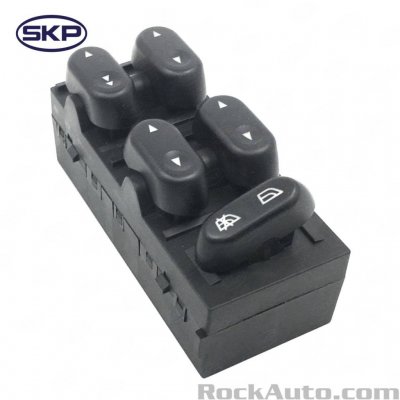

Your windows not working may be a bad master window switch there on the drivers door. They get corroded because people open the door in the rain and water gets into the switch, eventually causing it to fail.
Door Jamb Switches at Rock Auto
Window Switches at Rock Auto
Left Door Jamb Switch ......
Window Master Switch .....
