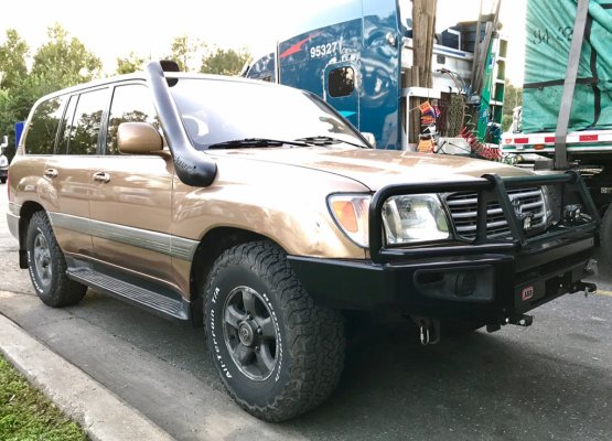

CMILES,
I will say this, I really really love my truck. I will keep throwing money at it with the hopes of enjoying its plethora of creature comforts and generous helping of horsepower/torque, but when it’s time to send this truck to its new owner, my wife and I already determined we are back to Lexus/Toyota. I hate how bland they are...zero innovation, terrible MPG pretty much all the time, but my Land Cruiser never, ever left me stranded. Ever. 300,000 miles of trouble free driving. Same with my Toyota Camry, Tercel, Corolla, and Tacoma. They all ticked like a clock. We are eyeing the Lexus LX570 as we did enjoy our Land Cruiser muchly. 06d049a0d773c7fa2343b74778c8bc92.jpg

That LC is nice! Even with a ton of miles on older LC, the used price is high. They are hard to find for a good price as people hang on to them.
