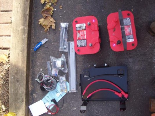

Forgot to mention Larry at dirty parts out of LA help me get my kit
nice guy got the kit up here fast, no problems, check them out

How mich was the kit? I need to add one for the lights I have
It wasn't cheap, $350 plus the two red tops
I looked at putting together one ,painless wiring soleniod , tray and wiring etc... and it wasn't that much cheaper. The Wrangler kit is clean and simple.

Yes I did the 2nd battery more for shows when the lights ( strobes & neons) are on and stereo and tvs going. The 1st Mod was going with a bigger quality made high out-put Alt. Mine puts out 145amps at idle.
THERMO: The set-up I'm running is the following.
Mode 1 Starts with main Battery, charges both, but isolates both when Ign off.
Mode 2 Main starts and is charged, disconnects the Aux battery completly,
Mode 3 Connects both batteries together with Ign off or on. Can be used to join the two batteries for boosting or winching.
Hopefully this setup works well, I leave mine in mode 1 of course. Like I said before I like the switching ability.
