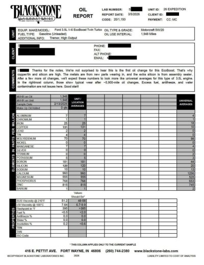

Attached:
My oil analysis for a fun read.
So-far, so-good
